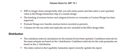

Re: Fit Normal() - Differences of parameter estimates standard error and confidence intervals between versions (JMP 16 vs JMP 18.2)
This is all I could find related to the issue.  "The confidence interval calculations for the normal fit have been updated."
