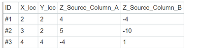

Hi All,
I have a table like below and want to find the String "Z", "A" and "B" in the columns and rename it to "Z_A" and "Z_B".
After that, I want to add a column after X_loc and Y_loc which converts them to mm. The formula that I want to use is (X_Loc / 1000).
Can anyone guide me on how to do the scripting for this?
Thanks

  4. Below is a script that if you have setup your data table correctly, should show you one way to solve the problem
    Names Default To Here( 1 );
    // Create a sample table
    dt = New Table( "Example",
    	Add Rows( 3 ),
    	New Column( "ID", Character, "Nominal", Set Values( {"#1", "#2", "#3"} ) ),
    	New Column( "X_loc", Set Values( [2, 3, 4] ) ),
    	New Column( "Y_loc", Set Values( [2, 2, 4] ) ),
    	New Column( "Z_Surce_Column_A", Set Values( [4, 5, -4] ), Set Display Width( 118 ) ),
    	New Column( "Z_Source_Column_B", Set Values( [-4, -10, 1] ), Set Display Width( 133 ) )
    // Wait 5 seconds so you can see the beginning table
    wait(5);
    // Loop across the columns to find the ones to change
    For( i = 1, i <= N Cols( dt ), i++,
    	If(
    		Contains( Column( dt, i ) << get name, "Z" ) & Contains( Column( dt, i ) << get name, "A" ),
    			Column( dt, i ) << set name( "Z_A" ),
    		Contains( Column( dt, i ) << get name, "Z" ) & Contains( Column( dt, i ) << get name, "B" ),
    			Column( dt, i ) << set name( "Z_B" )
    // Create the new column and move it to where it is to be located
    dt << New Column("The New Column", formula(:X_loc/1000));
    dt << go to(:The New Column );
    dt << Move Selected Columns(After(:Y_loc));
