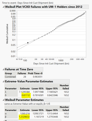

Not sure how Extreme-Value Parameter Estimates compare to  alpha/beta estimates used in the Weibull Parameter Estimates for days to failure plots.
Understand beta of >1 means in Weibull indicates the device will continue to failure over-time, is the Extreme-Value Estimates just a transform of the Weibull Analysis?

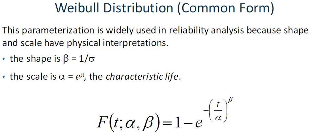

The Weibull distribution cumulative distribution function is related to the Smallest Extreme Value distribution CDF:
(JMP Training course)
The SEV distribution:
The Weibull CDF above can be transformed from a location-scale parameterization to a scale-shape parameterization:
The interpretation of the shape parameter is specifically:
I am not sure if this information is helpful. Continue to ask questions if it is still not clear.
