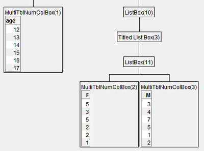

To get the tree structure I use these commands:
rtb = tb << report;
rtb << show tree structure;
The relevant portion of the tree structure is here:
I want to extract the values from these three multitblnumcolboxen.  How do I do it?  This doesn't work:
age_list = rtb[multitblnumcolbox(1)] << Get values;
f_list   = rtb[multitblnumcolbox(2)] << get values;
f_list   = rtb[multitblnumcolbox(3)] << get values;
Get Items doesn't work either.  Thanks for any suggestions!
Peter

I got a little farther by using GET TEXT:
age_txt = rtb[multitblnumcolbox(1)] << Get Text;
f_txt   = rtb[multitblnumcolbox(2)] << Get Text;
m_txt   = rtb[multitblnumcolbox(3)] << Get Text;
I can parse these strings into lists
crlf     = hex to char("0D0A");
age_list = words(age_txt, crlf);
f_list   = words(f_txt, crlf);
m_list   = words(m_txt, crlf);
Is there a better, more direct way?
