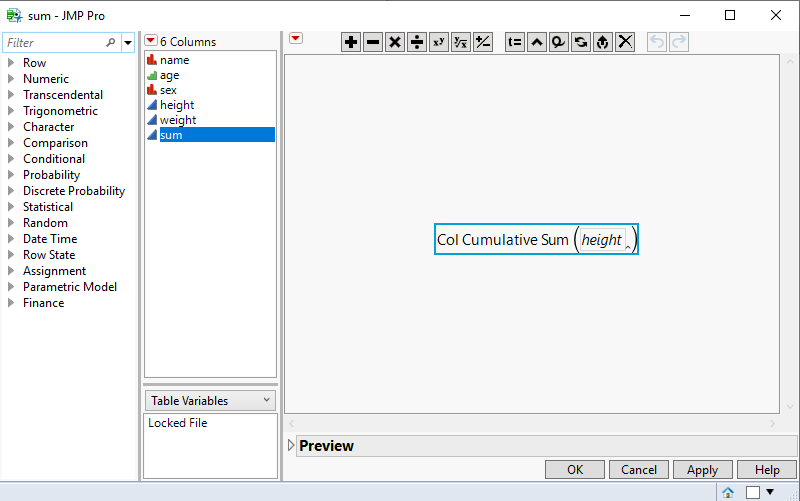

I ran the simple script below, using JMP 14.3 in Windows 10, and did not have an issue.
Names Default To Here( 1 );
dt << New Column( "sum", formula( Col Cumulative Sum( :height ) ) );
pic = Expr As Picture( dt:sum << get formula );
nw = New Window( "formula", <<journal, olb = Outline Box( "Formula Picture" ) );
olb << append( pic );
My first suggestion is for you to upgrade to JMP 14.3.  If that does not fix the issue, could you provide more specifics about your script so the Community can take a closer look at it?
