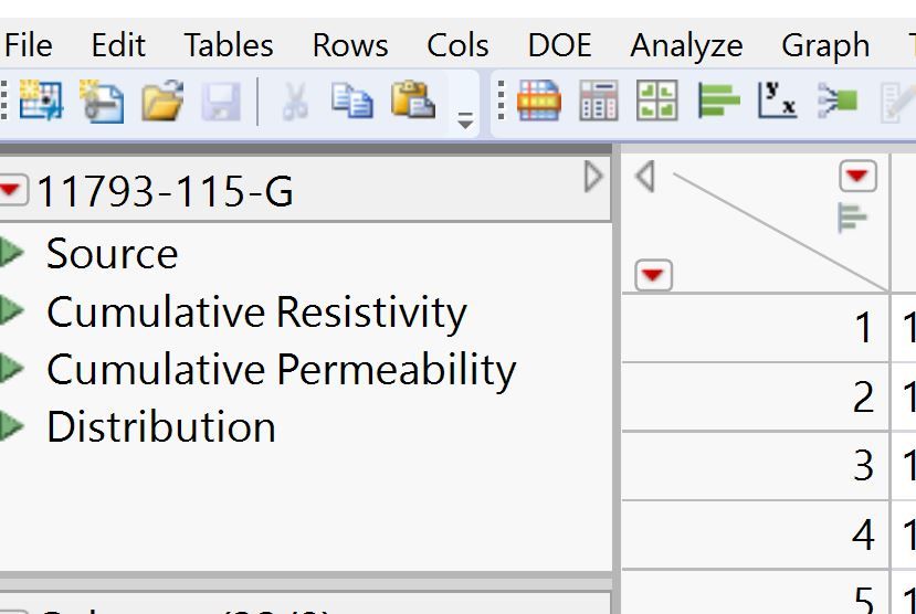

I just stumbled upon this thread, and I think it is what I've been after. However, I'm still trying to get over the JSL learning hump and I can't quite get the result.
Quick summary:
            - merged CSV data sets into one JMP sheet
            - created and saved plot scripts to data table
            - When opening table at a later point, I run the the three plot scripts, then I copy and paste each plot into a                     single Powerpoint slide (images that correspond to plots have been pasted already in same slide)
I'm looking to minimize the click and copy steps by at least pooling all three graphs together and get them in a format that can export all three at the same time. I've been exploring if this needs to be done with a Dashboard or Journal which somehow groups and saves as a file I can pull over. The holy grail would be to have my jpg images mated with my JMP plots and then brought over to PP.
I have tried the Vlist command but get an empty window when trying to get the plot that was saved as a script. Part of the relevant script pieces are shown.
Any thoughts or input are welcome.
Neil

pmroz
Re: Exporting multiple Graphs with different scripts
Hi NRW - I think you are over complicating things somewhat.  You don't need to put your join logic into an expression.  Just run it as is without the surrounding expr().
The graphs logic got cut off in your posting, but that I would do as expr(), rather than eval expr().
Finally in your new window just put
graphs,
and not
graphs("Cumulative Resistivity"),
NRW
pmroz,
Many thanks for the input! Being a novice, I'm still getting use to JSL flow and functionality, and would be glad for expert guidance. I included the entire script (pared down), to show you the overall flow. Based on previous coding experience which considered a main macro and subroutines, I was trying to encapsulate routines in expressions so they could be called later in program ("Files()", "Join_files", and "Con").
I changed "Graphs = Eval Expr" to "Graphs = Expr", and everything works. I wasn't sure if this needed an Eval since it was called in another expression (Join_files).
I had used graphs in new window, but still get an empty window.
Many thanks again for your valuable time.
Neil
pmroz,
I'm still getting a blank window when trying to open "Graph". Is there something fundamental that I need to include? My objective is to put all three plots (Graphs, Graphs2 and Graphs3) into one window so I can copy and paste into Powerpoint.
Many thanks for any input.
Neil
