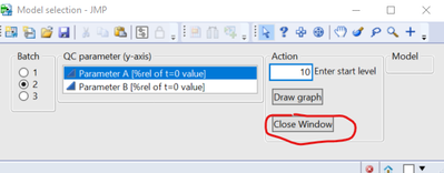

How can I make this error message here go away?
It appears when I close table and window via the "Close Window" button after I have first drawn a graph. I copied in the script below, but to run it one would have to have open an adequate data table (see attached example). This, and only this table, should be open when running the script. This script is an attempt at having a little desktop stability calculator (very dirty, reasonably quick) / helper when writing reports, assessing product shelf-life etc.. It lets the user apply our normalized stability data (where t=0 corresponds with 100%rel.) to hypothetical starting concentrations of any quality parameter (as far as it is numeric) and quickly switch between settings and parameters. I made it thus far, but this error message is driving me nuts. (Also, can I show this on the next In-Person Nordics User Group: 05 October 2022 ?)

					Button Box( "Draw graph",
						If( ( Is Empty( startLevel ) + Is Empty( yColRel )) > 0,
							// then
							New Window( "Message", modal,
								V List Box(
									Text Box( "QC parameter selection and/or start level missing!" ),
									Spacer Box( size( 0, 10 ) )
							// else
							action_expr
					Spacer Box( Size( 0, 10 ) ),
					Button Box ( "Close Window",
						If( !Is Empty( PF ), PF << Close Window);
						nw << Close Window;
						Close(dt, no save)
