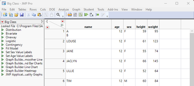

I want to split a string in a character column into two lines - by adding a newline.
name[1] = "A\!nB"
Can I do this directly when editing the cell - Alt + Enter doesn't seem to be right?

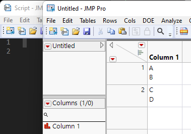

Here's one way, which is admittedly a bit of a hack:
  1. Open a new script window
  2. Hit enter
  3. Shift+up arrow to select that new line/carriage return
  4. Copy to clipboard, Ctrl+c
  5. Back to data table, enter first line, then Ctrl+v to paste, then enter second line.

Re: Enter "NewLine"
Your code seems to work the way you thought it would.  I just had to expand the height of the rows to have it displayed.
names default to here(1);
dt =
// Open Data Table: Big Class.jmp
// → Data Table( "Big Class" )
Open( "$SAMPLE_DATA/Big Class.jmp" );
:name[1] = "A\!nB"
Jim

and is this possible without JSL, just by typing?
Re: Enter "NewLine"
  2. Hit enter
hogi
Level XIII
Re: Enter "NewLine"
Nice trick - thanks :)
