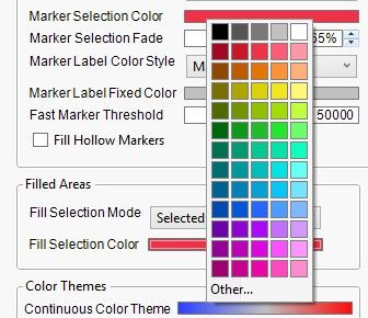

Mildly related question: Is the color pallette scriptable? I see the "colorbox()" dislplay box but the scripting index says it is only accesible by the platform. I don't necessarily need it, as I was able to find a couple workarounds. An example of what I mean by this is shown below the code here.

Color pallette, example from user preferences:
