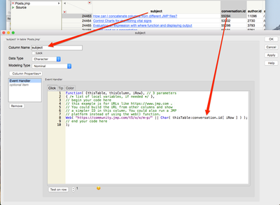

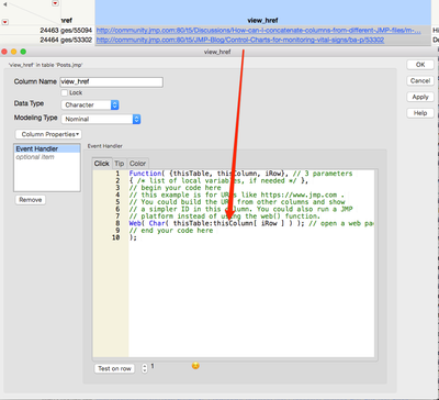

JensRiege
Level IV
Re: Does jmp allow the contents of a cell to be a hyperlink
Is there a example that can demonstrate this in a simpler way? The example in the guide appears very complicated. Can someone provide a simple JSL example of just a column with two rows, where there is a hyperlink in each of the two rows?
