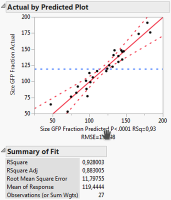

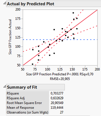

Out of curiosity, why is the "rep" factor not included into the RSM (or not allowed to be)? I just compared the two results
Following your guidelines:
Including it into the RSM:
What I can see, is that the first model includes less factors, namely X1, X2, X3, X3*X3 and Xrep, whereas the second model uses X1*Xrep, X2*Xrep and X3*Xrep additionally. Thus it has more terms and might overfit. However, all criteria like Rsq adj., BIC and AICc are also better for the 2nd model.
The results of the optimization are very similar.
Using simply common sense, I would imagine that during each replicate run, the input factors varied which these terms would take into account.
Or am I totally wrong and this simply forbidden?
