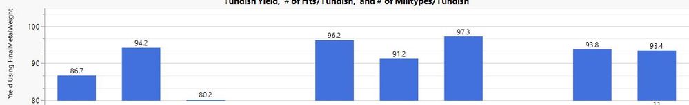

Display Labels for Values Outside Axis Range in Graph Builder
I am trying to build a chart in graph builder with fixed axis settings (80 to 105) to incorporate into a script. Occassionally, the values are below 80, however I still want them to display at the bottom of the chart. Will Jmp allow for this or will it only display values within the axis range?
Graph showing labels with a fixed axis:
Graph showing labels w/ an unfixed axis:

JMP will only display the bars that fall within the min and max values specified for the x axis.  However, using JSL you can determine the min and max values in the data, and then dynamically set the graphs min and max values.
