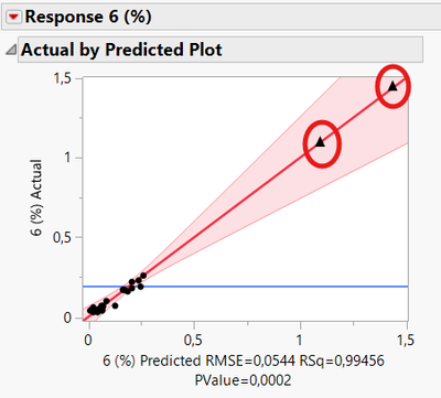

As the publication is not open access to see the details about the hypothesis and choices made for the analysis, it's hard to follow for me. Based on the data provided in the supplementary materials, I reproduced the design and analysis.
What is already quite interesting is that the design contains some response values for specific points that seem outliers for some responses and may have some influence (high Cook's Distance) on the regression model :
Domain expertise would be needed to assess if these points are "normal"/expected or not, what to do with them (exclude, transform responses, etc...) so I won't be of any help for this part.
You can still have a look at the data and models created, compare them with the ones from the publication, and look at the Profiler/Design Space Profiler script.
