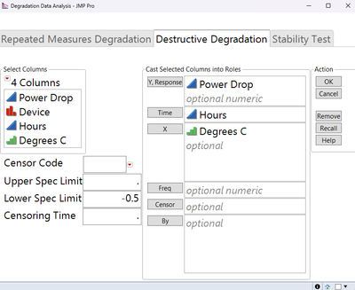

In that case, you want to use the Destructive Degradation platform instead, so that you can relate the prediction to the temperature that is used and not the specific equipment. Open up the platform and fill it as so.

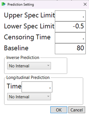

Once that’s run, go to Red Button > Prediction Settings and apply your baseline to the process, then run the model as you have done.

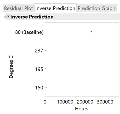

Then you will see your inverse predictions for 80C in the report tabs below, you can click the red button here and ‘save crossing time’
The 'after 130,000 hours' part doesn't play into here because you're looking for an inverse prediction of the temperature, to provide a failure time.
