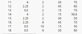

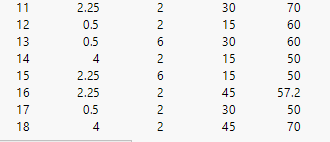

I have done a half-factorial screening with 4 factors, and now would like to augment the design to include the rest of the missing 2-way interactions and axial points to check for quadratics.
When I use the DOE -> Augment Design ->Augment-> RSM and 2nd interactions, the number of suggested runs is always 18 (10 previous runs and 8 new runs as the augmented design) , however, the actual runs change every time that I try these same steps. I have two examples pasted below.  I'd like to know why does this happens and why the runs change.
And my second question is regarding the "weird" non-Integer values suggested by JMP (56.6 and 57.2 in the tables below - the range for that factor has been set to 50-70). Why does JMP require a run at these specific values instead of the mid point which in this case will be 60? Is this related to the optimality criteria (D-optimal vs I-optimal)?

The number of suggested runs does not change ( it is always 8) , but the values of the factors in those 8 runs change. For instance, in the first try, JMP suggested to run with factors at levels (4,2,15,56.6). But this combination does not appear in the next try.

There are multiple options of extra runs which will give the same/similar optimality.

The combinatorial design methods are deterministic. They will always arrive at the same result. Augmentation in JMP uses Custom Design. Custom Design, though, is an algorithmic method that starts with a (horrible) random design for the new runs. It iteratively improves the design until the chosen optimality criterion is optimized. Hence, we call it optimal design. The random starting point is one reason you are not guaranteed to arrive at the same result. In fact, Custom Design does not search once for the optimal design. It might be locally optimal, so it repeats the search process many times. Each time it starts with a new random design.
Also, it is often the case that there is more than one design with the same optimality. JMP can no longer distinguish designs. Repeating the augmentation process is likely to arrive at a different result.
