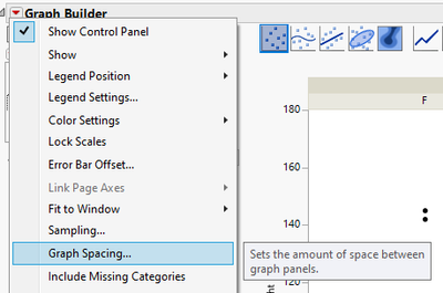

Try setting Graph Spacing to from red triangle menu
-Jarmo

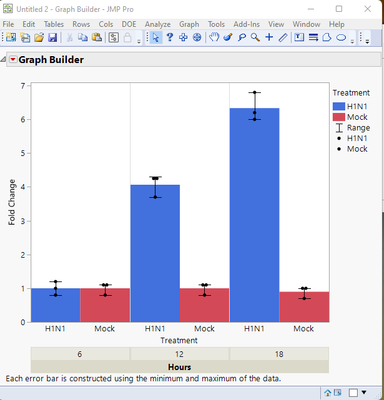

Here are the results I was able to produce

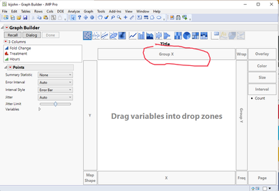

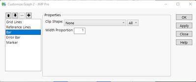

The first notable change, is that I specified Hours as an X axis group.  The grouping display has also been moved to the bottom of the chart.  By grouping, the different charts in the groups will be treated as separate charts.  So what I then did, wans to right click on the graph, and select Customize.  In the Customize window, I selected Bar, and set the Width Proportion to 1
I did this for each grouping.  This resulted in the below graph
I then went into the X axis settings and changed the range of the X axis from -.5 <> 1.5, to -1 <> 2
which resulted in the final chart,

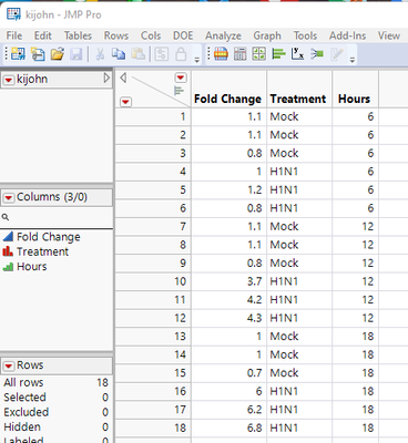

Here is the data table I used(it is also attached)

Re: Customizing space between bars in graph builder/aligning data points to bar graph?
Hello, Thank you for your very quick response! I'm a little new to JMP, so where do you go to specify hours as an x-axis group? I think once I do that I will be able to replicate the rest as you've shown.
txnelson
I strongly suggest that you take the time to read the section on Graph Builder in the Essential Graphing document found in the JMP Documentation Library, available under the Help pull down menu
Jim

jthi
-Jarmo
kijohn
Level I
Great, got it! Thank you both for your help!
