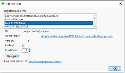

If the commands of different add-ins are added to the same Toolbar, the Load Order setting in the ViewAdd-Ins menu specifies the order.
Sometimes, one can use the up/down arrows to change the order - sometimes this doesn't work (?!?).
Then one can key in another number and press enter - which will close the dialog and move the Add-In to the new position.
