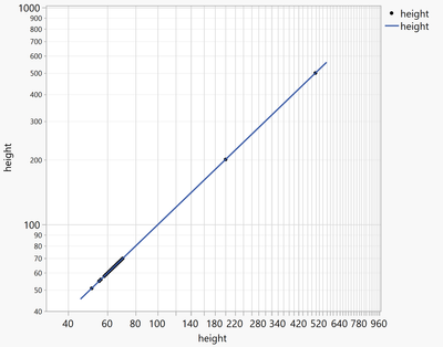

Let's start with the example from the Scripting Index. We want to generate a Log plot manually - and learn from it:
Names Default To Here( 1 );
Open( "$sample_data/big class.jmp" );
gb = Graph Builder(
	Variables( X( :height ), Y( :height ) ),
	Elements( Points( X, Y, Legend( 2 ) ), Smoother( X, Y, Legend( 1 ) ) ),
	SendToReport(
		Dispatch( {}, {:height}, ScaleBox( 2 ),
			{Scale( "Log" ), Max( 1000 ), Minor Ticks( 1 ),
			Label Row( Show Minor Grid( 1 ) )}
gbr = Report( gb );
gbr[axisbox( 1 )] << scale(
	custom scale,
	Scale To Internal( Function( {x}, If( x > 0, Log( x, 2 ), . ) ) ),
	Scale To External( Function( {x}, Power( 2, x ) ) )
) << Min( 32 ) << Max( 100 );
There is a function Scale to Internal() which is used to apply the log() to the X axis - and a Scale to External() which is the inverse function.
After executing the code ...
a)  the user get a log scale on the X axis (compare with the default Log scale on the Y axis):
[add some data points @ 200, 500 , ...]

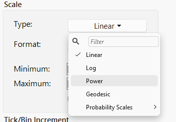

b)  Custom Scale appears in the axis menu
c) ... and the user gets access to Cube Root and Johnson Su scale.

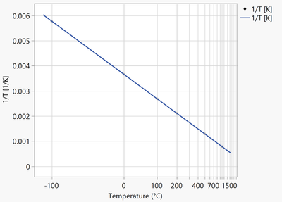

In analogy to the previous example, one can use
current report()[axisbox( 1 )] << scale(
	custom scale,
	Scale To Internal( Function( {x}, if (x>-273, 1/(x+273)) ) ),
	Scale To External( Function( {x}, if (x>0,1/x-273)) )
) << Min( 30 ) << Max( 100 ) << Inc(2);
... to plot Temperature [°C] on a 1/K scale :)

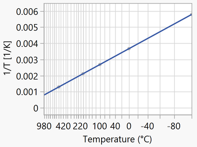

and with
one gets:

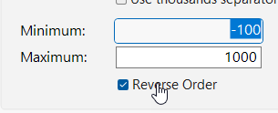

  • Temperature runs from left to right, this is great!!! Nevertheless, besides Reverse order, can I also change   Scale to Internal / External() to make the temperature run from right to left.

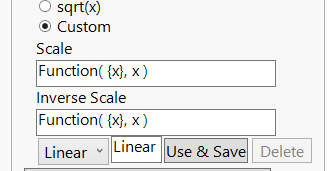

The Degradation Platform provide the same cool options to use custom axis scales for the fits:
dt = Open( "$SAMPLE_DATA/Reliability/Device B.jmp" );
dt << run script ("Degradation");
Better than Graph Builder:
The user can write the function and inverse function directly in the GUI:
