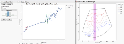

Not sure if your 2D plot it based on points or a formula. If points, you could use graph builder to plot your target value against one dimension in your chart with a data filter to define the 'slice' in the other dimension.

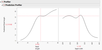

If you are exploring a column formula, then I agree with @Mark_Bailey that the profiler is the easiest approach. Just change the value of one value and see the plot on the other.

Names default to here(1);
dt = Open("$Sample_data/iris.jmp");
New Column("H1_1", Numeric, "Continuous", Format("Best", 12), Set Property("Notes", "Model NTanH(3)"), Formula(TanH(0.5 * ((-3.50407799736543) + -1.69201212624413 * :Sepal length + 4.45798369366822 * :Sepal width))), Set Property("Intermediate", 1));
New Column("H1_2", Numeric, "Continuous", Format("Best", 12), Set Property("Notes", "Model NTanH(3)"), Formula(TanH(0.5 * ((-4.34695576142641) + 0.578814453314083 * :Sepal length + -0.387699136913814 * :Sepal width))), Set Property("Intermediate", 1));
New Column("H1_3", Numeric, "Continuous", Format("Best", 12), Set Property("Notes", "Model NTanH(3)"), Formula(TanH(0.5 * ((-14.9199578715582) + 8.0363609653296 * :Sepal length + -9.32672254743267 * :Sepal width))), Set Property("Intermediate", 1));
New Column("Predicted Petal length", Numeric, "Continuous", Format("Best", 12), Set Property("Notes", "Model NTanH(3)"), Formula(9.72824082889675 + 0.825393378043811 * :H1_1 + 8.38378988028562 * :H1_2 + 1.62929374850912 * :H1_3), Set Property("Predicting", {:Petal length, Creator("Neural")}));
New Window("Plotting points",
	H List Box(
		Graph Builder(
			Size( 522, 456 ),
			Show Control Panel( 0 ),
			Variables( X( :Sepal length ), Y( :Petal length ) ),
			Elements( Points( X, Y, Legend( 295 ) ), Line( X, Y, Legend( 297 ) ) ),
			Local Data Filter(
				Add Filter(
					columns( :Sepal width ),
					Where( :Sepal width >= 2.9 & :Sepal width <= 3.1 )
		Contour Plot(
			X( :Sepal width, :Sepal length ),
			Y( :Petal length ),
			Show Data Points( 0 ),
			Fill Areas( 0 ),
			Label Contours( 0 ),
			Transform( "Range Normalized" ),
			Specify Contours( Min( 2 ), Max( 6 ), N( 5 ) ),
			SendToReport(
				Dispatch(
					"1",
					ScaleBox,
					{Add Ref Line(
						{2.9, 3.1},
						"Solid",
						"Medium Dark Magenta",
						"Slice",
						1,
						0.25
//Profiler
Profiler(
	Y( :Predicted Petal length ),
	Profiler(
		1,
		Term Value(
			Sepal length( 6.302, Lock( 0 ), Show( 1 ) ),
			Sepal width( 3.125, Lock( 0 ), Show( 1 ) )
	Expand,
	SendToReport(
		Dispatch(
			{"Prediction Profiler"},
			"Profiler",
			FrameBox,
			{Frame Size( 320, 260 )}
		Dispatch(
			"Profiler",
			FrameBox( 3 ),

dt << Profiler(
	Y( :Z ),
	Profiler(
		1,
		Term Value( X( 0, Lock( 0 ), Show( 1 ) ), Y( 0, Lock( 0 ), Show( 1 ) ) )
	SendToReport(
		Dispatch(
			"10000",
			ScaleBox,
			{Min( 72.5 ), Max( 125.754437869822 ), Inc( 10 ), Minor Ticks( 0 )}

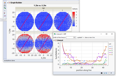

Re: Cross section of a 2D plot
A solution is now available via Graph Builder Toolbar
