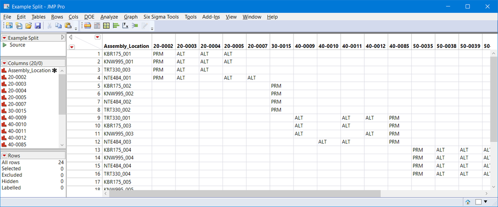

Based upon your discussion with Jim, I would reorganize the data:
  • Split the table, and
  • Sort it
The resulting table (a portion show below) would reduce the selection of comparable assemblies dramatically.
Here is a graphical picture of this table
The script to do this attached.  What I would do is the following:
  • Add a column in the original column called  Type Code that is 2 when Type = PRM and 1 when Type= ALT.
  • Then split the table (temp) and recode missing with zero
  • I would still sort the table, but this is unnecessary.
This table with the parts columns now being numeric columns can be used in cluster algorithms and nearest neighbor algorithms.
