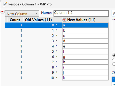

You can also use Recode
and it will use Map Value
Map Value(:Column 1, {0, "a", 1, "b", 2, "c", 3, "d", 4, "e", 5, "f", 6, "g", 7, "h", 8, "i", 9, "j", 10, "k"})
