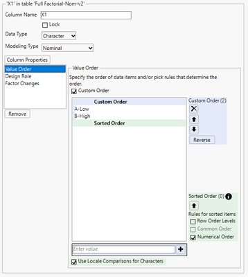

Thanks, Dan - Your response is getting to the heart of the question, describing the coding convention for nominal factors. I'm understanding what you wrote to mean that the last level listed will be coded to be the "base level" = +1.
I'm sorry I mistakenly uploaded the design table after I'd reversed the Value Order for X1 to see what would happen. Just to start fresh, here's a new design table attached with Value Order for all factors set as you described: low level listed first, high level is second. See below for the default Value Order dialog for X1 after re-running the DOE creation. The other factor levels are also listed in the same way. When I re-analyze I still do get coding reversed from the original design pattern. Updated coding table also attached.

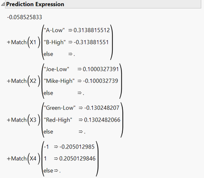

With the revised files, you are using JMP's default coding. The low level will be displayed in the parameter estimates. The high level parameter estimate will be the opposite value of the low level parameter estimate since you only have two levels. One way to see this is to choose the red popup menu and select Estimates > Show Prediction Expression. I only copied the main effects.
Remember that when you use a Nominal modeling type, they are truly just names. It really is irrelevant on which value is the "low" setting and which one is the "high" setting.
If your factors are numeric, continuous, the coding formula is X-Midrange(X)/( Range(x)/2) and is NOT the same as how coding is done for nominal factors. Since you are using nominal, the formula is not and can not be used. The details on what JMP does can be found in the Fitting Linear Models > Standard Least Squares part of the JMP Documentation. I have included part of that explanation in the attachment.
