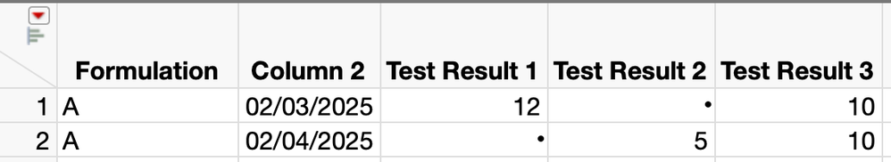

My formulation was tested in 3 ways. My data set includes the testing dates alongside the results. Test Result 3 is date agnostic so it appears in my data set in both rows. I want to consolidate my data so that it is not separated in rows by date of testing.
I would like to go from something like this:

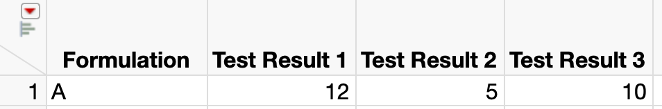

to something like this:

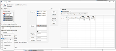

one option: create a summary table
- with just one value (plus many empty rows) it doesn't matter if you use min, max, mean or median ...
- use "column" as name format - to get rid of the aggregation info.
