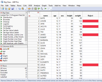

The formula processor complained when I attempted to set the cell color from a column formula, however, below is a simple script that works.
Names Default To Here( 1 );
dt << New Column( "Reject", character );
For Each Row(
	If( :weight > 120,
		:reject << color cells( "red", Row() ),
		:reject << color cells( "white", Row() )
Jim

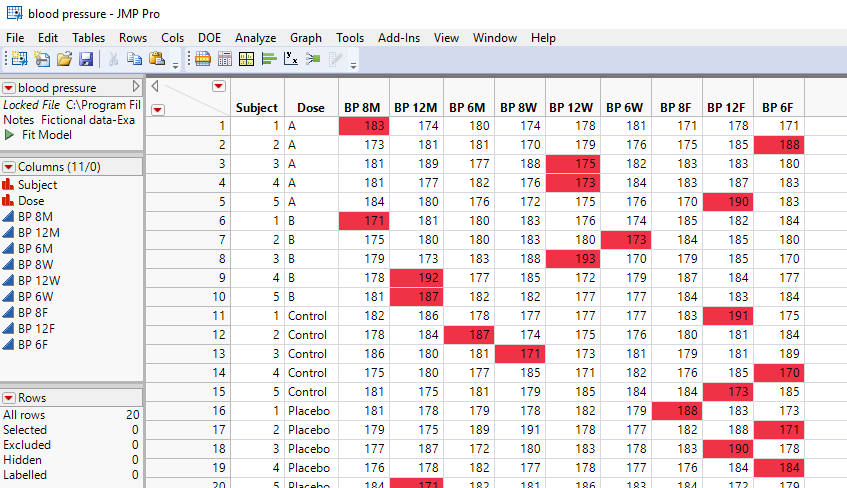

I am still confused as to what "Mean" you are referring to?  But, the code below takes a guess at one of the possible means to compare with, and from it sets the cell with the max difference from the mean.
// Open the sample data table
dt = Open( "$SAMPLE_DATA/blood pressure.jmp" );
// Loop across rows to find what cells have the max values
For Each Row(
	// Find the mean for the target columns in the row
	rowMean = Mean( :BP 8M, :BP 12M, :BP 6M, :BP 8W, :BP 12W, :BP 6W, :BP 8F, :BP 12F, :BP 6F );
	// Initialize the memory variables to hold the max value and the column the max value is in
	MaxVal = 0;
	Col = 0;
	// Loop across the columns in question and find the max value
	For( i = 1, i <= 9, i++,
		If( Abs( Column( i + 2 )[Row()] - rowMean ) > MaxVal,
			MaxVal = Abs( Column( i + 2 )[Row()] - rowMean );
			Col = i + 2;
	// Set the cell color for the cell that has the max value
	Column( col ) << color cells( "red", Row() );
