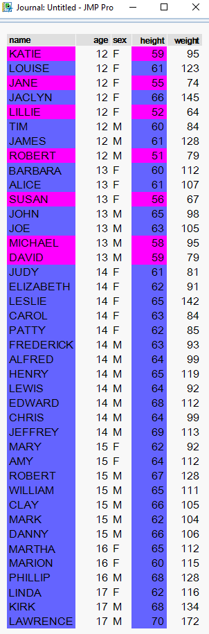

Hi - I want to apply a single conditional formatting rule to two columns of data in a Table Box. I've set up below an example using the Big Class data set which illustrates the problem, in which I can easily do what I want within a data table, but producing the same effect within a Table Box seems to be a bit more tricky.
The mechanism for creating the conditional format for a column of a Table Box is completely different to that needed for a data table, and requires that I set up a rule within my Preferences as shown. This part is straightforward enough, but I can't see a way then to apply that rule to a column other than the one to which the rule directly relates.  Can it be done?

I do not have a solution that will create a Conditional Formatting Rule.  However, I have accomplished what you want, by moving the colored data table into a journal, and then appending TableBox(1) from that journal into the application that I am creating
Jim

Many thanks Jim - that's ingenious!
Just for the record, I'm adding below a copy of a modified version of my original script which incorporates your recommendation as to how to resolve this.  Thanks once again - this is going to be phenomenally useful to me.
