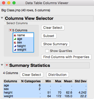

We could use some more details about what column information your looking for and how you'll use it but perhaps another option is Cols -> Columns Viewer.
-Jeff

Is there a way in the columns viewer to get the column attributes like 'Data Type' and 'Modeling Type'?
ian_jmp
Level X
Re: Column Information
If you want this information you could get it this way:
