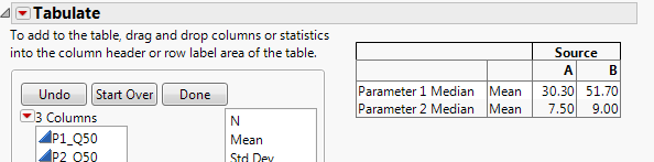

Expected output (by copying in the log the result of the show())
