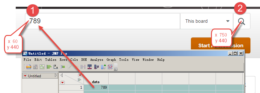

Can JSL control mouse movements and clicks, and input numbers in other Windows?
For example, dt[1,1]=789 in the JMP table DT
In addition, there is other software xxx.exe in the specified location of the screen, it has a text box to fill the content, the text box has a confirmation button right.
I now want to implement through JSL:Move the mouse to the textbox range of xxx.exe and click once,make it to the current focus, then DT [1,1] the value of 789 to fill in the xxx.exe text box, and then control the mouse to move to the xxx.exe button position, and click once to complete the confirmation.
  • The x and y values in the figure are the coordinates of XXX. Exe in the current screen
  • This is a strange idea of mine.Thanks Experts!

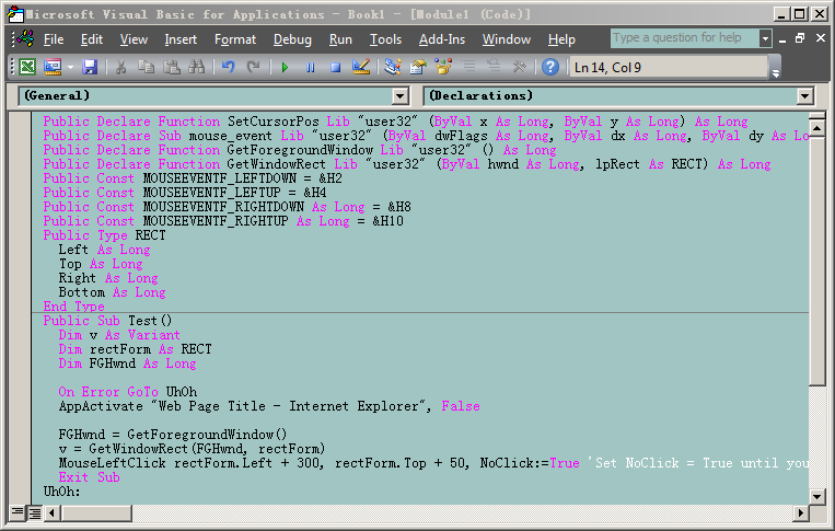

Excel's VBA can still do this.

However, VBA to complete the operation code has become more complex.
