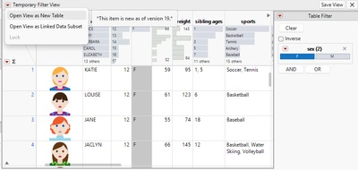

Please have a look at the new Filter Views in JMP19.
Maybe you can use the data table itself - and the filter view on the right side of the table:
when you are happy with the view, just open it as new table.
further details can be found in this talk : Developer Tutorial: Data Table Enhancements  by @Mandy_Chambers .
