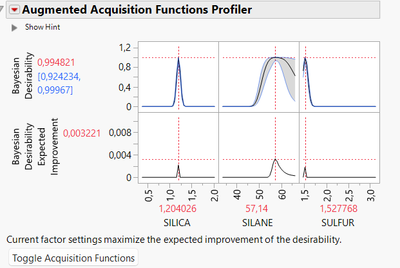

Depending on the acquisition function used and the calculation of confidence intervals, you can have different "optimal" next sampling point recommendation :
Maximize Bayesian Desirability :
Maximize Expected Improvement Desirability (Optimize predicted response regarding target):
Maximize Bayesian StDev Desirability (focus on where the uncertainty is highest):
