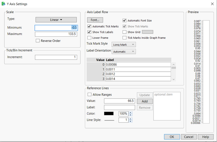

I wonder how I can present them in % in the graph. My axis setting (Fig 1) is different from what is shown in the Help page (Fig 2). How could I get there/ how to change them into better axis?
Thanks a lot!
Fig 1:  Axis setting in my computer

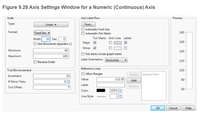

Fig 2: Axis setting in Help Page.

If I were to make a guess, the data you have has Character data type or Ordinal / Nominal modeling type and it should be most likely Numeric Continuous.
-Jarmo
statman
Re: Axis Setting in %
First, welcome to the community. If you simply select the Format drop down, you can select Percent
