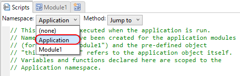

It's possible to call between modules, but not the recommended way to define a function that is "global" to the Application.  A module can be instanced more than one time, which means that you would have to query one of the instances to get access to the variables in its namespace.
The best way to define globals for your App is to define them in the Application namespace, which is visible to all module instances:
