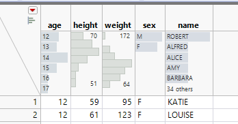

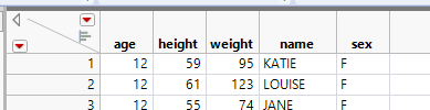

With this simple example you can see that JMP17 ignores the order of items in the list (or rather sorts alphabetically?)
JMP16:
JMP17:

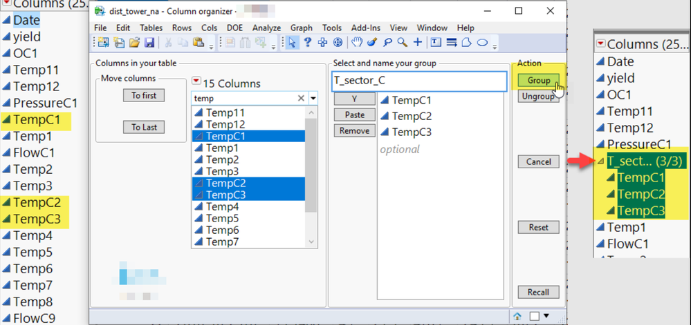

This will probably break the functionality in the column organizer add-in.
https://community.jmp.com/t5/JMP-Add-Ins/MES-data-retrieval-add-in-Aspentech-IP-21-and-Osisoft-PI-Av...
