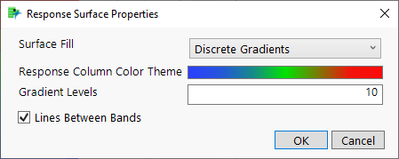

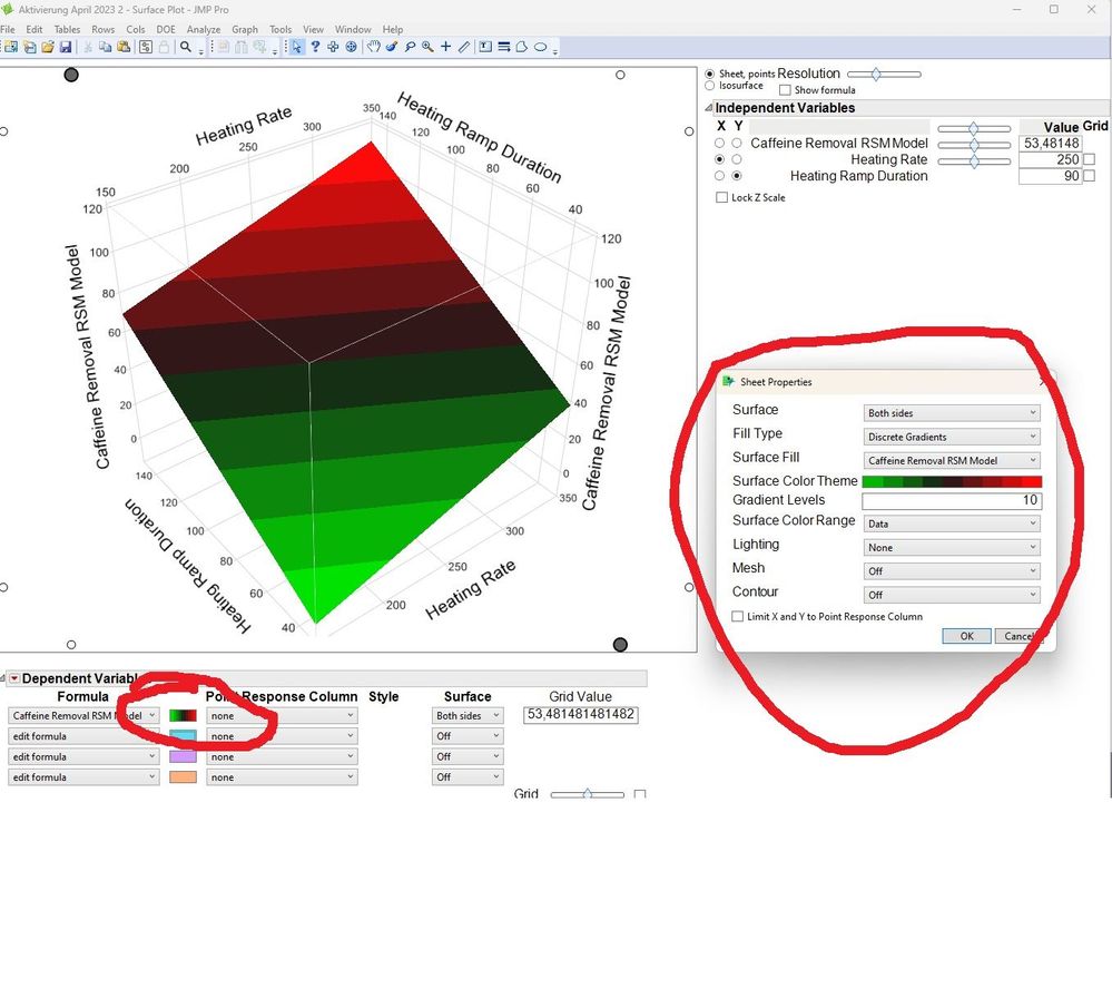

This works, so far. My problem is now that I would really like it to directly change the color type of my 3D plot to "discrete gradients". I tried:
objReport[SceneBox(1)] << Set Property("Fill Type", "Discrete Gradients");
objReport[SceneBox(1)] << Set Property("Number of Levels", 10);
But it seems that it cannot find the right objects to modify. I searched the "Sheet Properties" (see picture) in the Tree Structure of the plot, but couldn´t find it. My two lines of script have no effect.

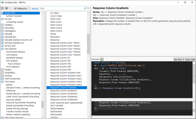

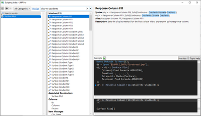

jthi
Re: Adjusting the Output Size of Surface Plot without JSL Script
Usually you start by making the modifications by hand checking out the script for possible messages you can use
Surface Plot(
	Columns(:Pred Formula ABRASION),
	Datapoints Choice("Surface"),
	Surface Color Theme("Green to Black to Red"),
	Surface Color Theme2("Green to White to Red"),
	Surface Color Theme3("White to Black"),
	Surface Color Theme4("Blue to Gray to Red"),
	Response Column Fill("Discrete Gradients"),
	Response Column Gradients(10),
	Response Column Color Theme("Blue to Green to Red"),
	Response Column Color Theme2("Blue to Gray to Orange"),
	Response Column Color Theme3("Spectral"),
	Response Column Color Theme4("Jet"),
	Response(:Pred Formula ABRASION),
	Equation(., ., ., .),
	Surface Color Method("Solid", "Solid", "Solid", "Solid"),
	SetVariableAxis(:SILICA, Axis Data({})),
	SetVariableAxis(:SILANE, Axis Data({})),
	SetZAxis(:Pred Formula ABRASION, Current Value(146.121949348339)),
	SetXVariable(:SILICA),
	SetYVariable(:SILANE),
	Iso Value(0, 139.119238722661),
	Frame3D(Set Rotation(-54, 0, 38))
and then if that isn't enough, take a look at scripting index as it might contain what you need.

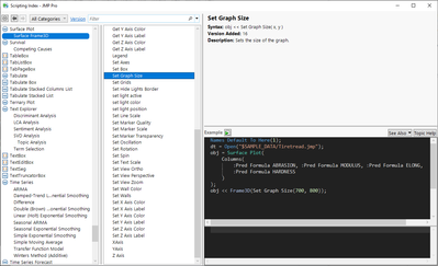

This same can also be true for the size. Resize it by hand and check the script JMP creates for you
	Frame3D(Set Graph Size(200, 200), Set Rotation(-54, 0, 38))
If this is the size you wish to change, then I went with much more complicated route in my first response (because I didn't bother checking for special messages that Surface Plot might use).
