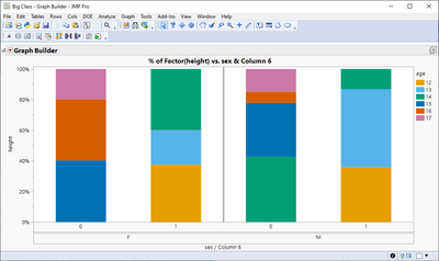

I think you would have to go with stacked bar chart.
Mosaic
% of Factor Stacked Bar chart with width proportion set to 0.95
-Jarmo

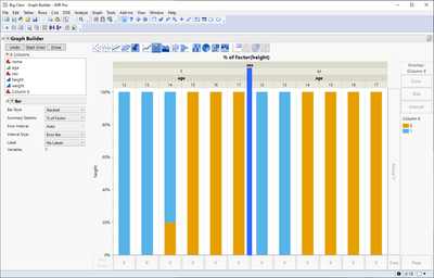

You could try adjusting Graph Spacing
It might add too much spacing for you as it will separate all the categories
You could also possibly move your X-Group columns to X-Axis and tinker with axis settings
-Jarmo

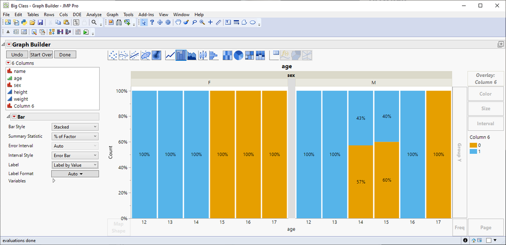

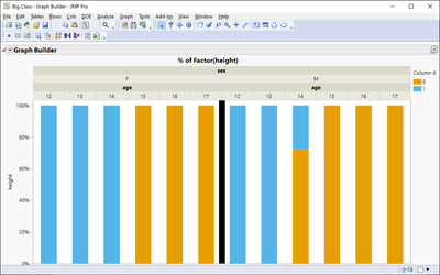

If you start with something like this
Move age to X-axis and add graph spacing
At least this way you could control the graph spacing but you will end up separating the groupings.
With scripting you could add V Line() when the "top group" changes (this is hard-coded example)
fbs = Current Report() << XPath("//FrameBox");
fbs[6] << Add Graphics Script(
	Pen Size(10);
	V Line(0.5)
fbs[7] << Add Graphics Script(
	Pen Size(10);
	V Line(-0.5)

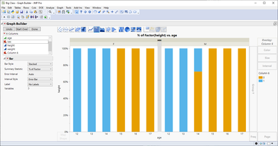

Something like this might be adequate.
(gb << XPath( "//FrameBox" )) << Border( Left( 2 ), Right( 2 ) ) << Margin( Left( 2 ), Right( 2 ) );

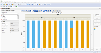

Re: Adding visual separator in graphbuilder/bar chart
For some reasons, when I place one category to X-axis, the width of the bar are changing (dim2 is set as nominal FYI)

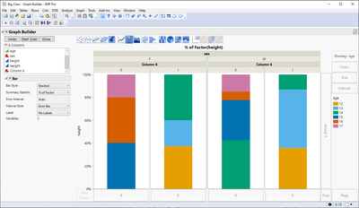

You are right jthi. This is Mosic plot. Do you know by chance a way to do the same plot as Mosaic but the width is not varying for the top level category?
