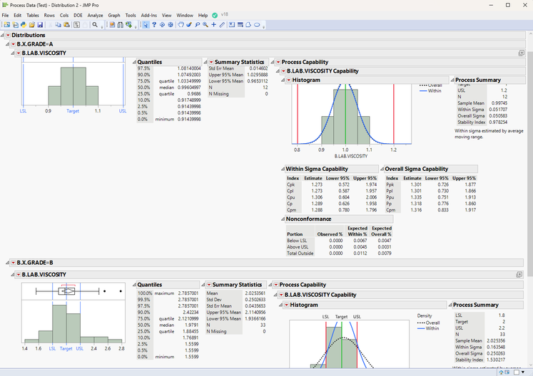

Currently there is not a way to handle 2 different sets of Spec Limits for one column as a built in function.
However, by using JSL one can specify different spec limits for one  column when there are multiple outputs.
Distribution(
	SendToByGroup( {:B.X.GRADE == "A"} ),
	SendToByGroup(
		{:B.X.GRADE == "A"},
		Continuous Distribution(
			Column( :B.LAB.VISCOSITY ),
			Process Capability( LSL( .8 ), Target( 1 ), USL( 1.2 ), Show as Graph Reference Lines )
	SendToByGroup(
		{:B.X.GRADE == "B"},
			Process Capability( LSL( 1.8 ), Target( 2 ), USL( 2.2 ), Show as Graph Reference Lines )
	By( :B.X.GRADE )
The above JSL can be easily modified to read the spec limits from your provided data table, rather that having hardcoded JSL as in the above JSL.

Currently the splitting is easiest method to handle this (can be most likely scripted to make it quite easy).
