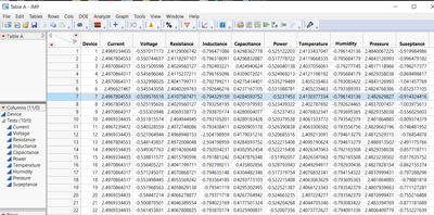

Table A:-

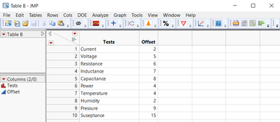

Table B:-
I want to add values from Table B Column name "Offset" to each Rows of Column Group "Tests" in Table A and generate a new data table file with values added.
P.S.- There are more than 100 columns in the Table A file. How can I use a for loop to iterate all rows and columns?
