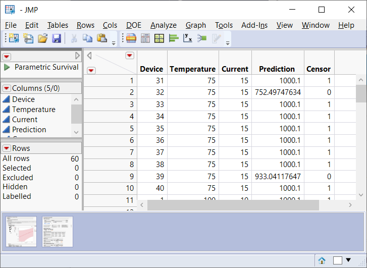

I apologize for a newbie question. I am doing reliability anlysis using the degradation platform. In the formula, I can set the option to save the crossing time using the statement below (save crossing time option is highlighted in bold)

This works great, and opens a new table. But I can't seem to figure out how to access the table in JSL, it does not give a name to it. See the image of the table below.  it just shows as "-"
How can I access it so that rename and manipulate the table?

change the last line so that you receive a table reference:
dt2 = obj << Save Crossing Time;
Now you can use this table reference to change the name etc.

Re: Accessing table of prediction data
Thank you so much! that was exactly what I needed and helped me understand the JSL scripting much better!
