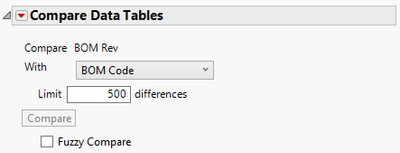

When I write script for "Compare Data Tables", found that limit setting doesn't work.
Even I put 2000, after running, it's still default 500.
Any idea I can make this setting work?
Thanks.
See below screen shot and the script:
Data Table( "BOM Rev" ) << Compare Data Tables(
	Compare with( Data Table( "BOM Code" ) ),
	Compare Data,
	Show Difference Summary,
	Show Difference Plot,
	Limit( 2000 )

  1. I replicated your findings
  2. There is not an element called "limit" in the documentation in the the Scripting Index........that makes me suspicious
  3. I would report this to the JMP Support Team at
    1. [email protected]
