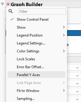

Or you could add two y-axis and use Parallel Y Axes
and similarly tinker with enable/disable variables until you get what you wish
