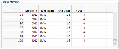

                In the example below, the preview indicates that we will get 3 numeric columns for our automotive data.
12332_pastedImage_47.png                  However, upon import the final column is typed as Character.
                If we use Show all rows in the Wizard, we can examine the data to see the issue and find that somebody has entered V4 and V6 for engine sizes.
