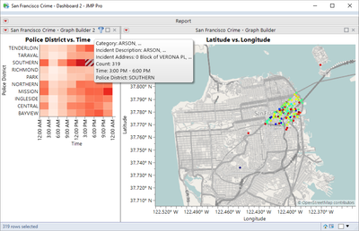

The Poster: In this presentation you will learn about the new docking panel display infrastructure for building report layouts that can be reconfigured dynamically.  These docking panels are used when creating Dashboards either using Combine Windows or with the Dashboard Builder.  The docking panel features are also supported in JSL for developers creating custom reports.  Dashboards can include Selection Filters to allow one graph to filter the others, and support Summary Report View to hide the details in each platform.  If your data is created as a result of using SQL Query Builder or JMP Query Builder, you have the option to rerun the query each time the Dashboard is run.  Improvements in interactive HTML output in JMP 13 allow dashboards to be reproduced in HTML for sharing purposes.  The poster files are attached.

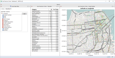

  • Multiple platforms sharing a Local Data Filter

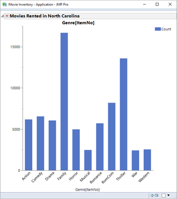

  • Creating custom applications incorporating multiple windows and JSL scripts
Along the way in the tutorial, many features of the new Dashboard Builder are introduced, including updates to the Combine Windows functionality, Docking infrastructure for rearranging the layout of live reports, and Report View options for hiding details of reports.  Interactive HTML dashboards are also demonstrated, using the new JMP 13 support for interactive Graph Builder output in HTML5.
